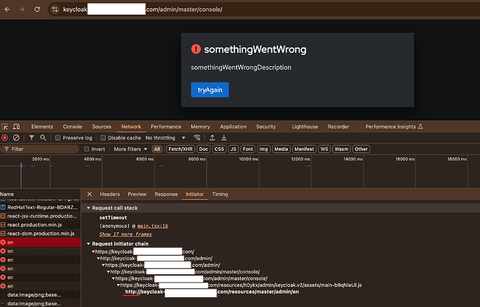

Hi,
I have problems when deploying a custom Keycloak docker image in the cloud.

When trying to load the admin console it returns the error below.
The error in the console loading happens when making requests to https://keycloak-.onrender.com/resources/master/admin/en, but if I try to access the same URL directly, it works, including using HTTP, which is redirected correctly to HTTPS.
I’ve researched a lot and tried some environment variables I found in similar post issues, but none has worked so far. The docker image works fine if I run it locally using Docker desktop.
Thank you in advance for any input.
Hey tom, proxy=edge is deprecated. If you sit behind a reverse proxy, look this up: Using a reverse proxy - Keycloak
Thanks a lot, @gmolaire! After reading the documentation, I got it working. The protocol https was missing in the hostname variable. I also removed the deprecated prox variable.
