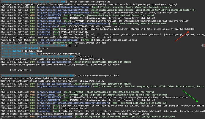

Hey, sorry for the late reply. You should use --http-port instead of http.port, then it’ll work :slight_smile: CLI is all dash-case. The new Version of Keycloak.X, which will be shipped together with KC16, will bring many enhancements, e.g. command completion for bash/zsh, so feel free to try it out by getting latest main from github and building via mvn clean install -DskipTests -Pdistribution :wink:

That works, but not with start-dev.
Thanks for the tips. I’ll check out the upcoming version.
No problem. You are right, there was a bug in 15 w.r.t. this. It’s solved in latest main, see attached screenshot :slight_smile:
