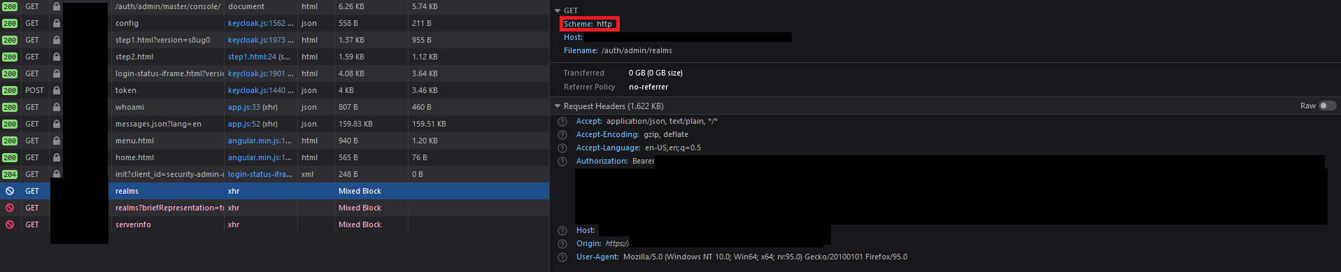

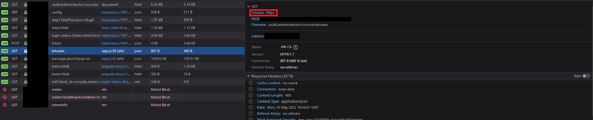

I am running keycloak behind an nginx proxy. The nginx proxy is terminating encryption using a self-signed certificate. Both keycloak and the nginx proxy are running as docker containers. My configuration works in dev mode, but in production I get a party blank screen when I try to access the admin console.
Does anyone know what might be causing this? I don’t see any obvious errors in the browser console or networking tab.
Here is an screenshot of my problem:
