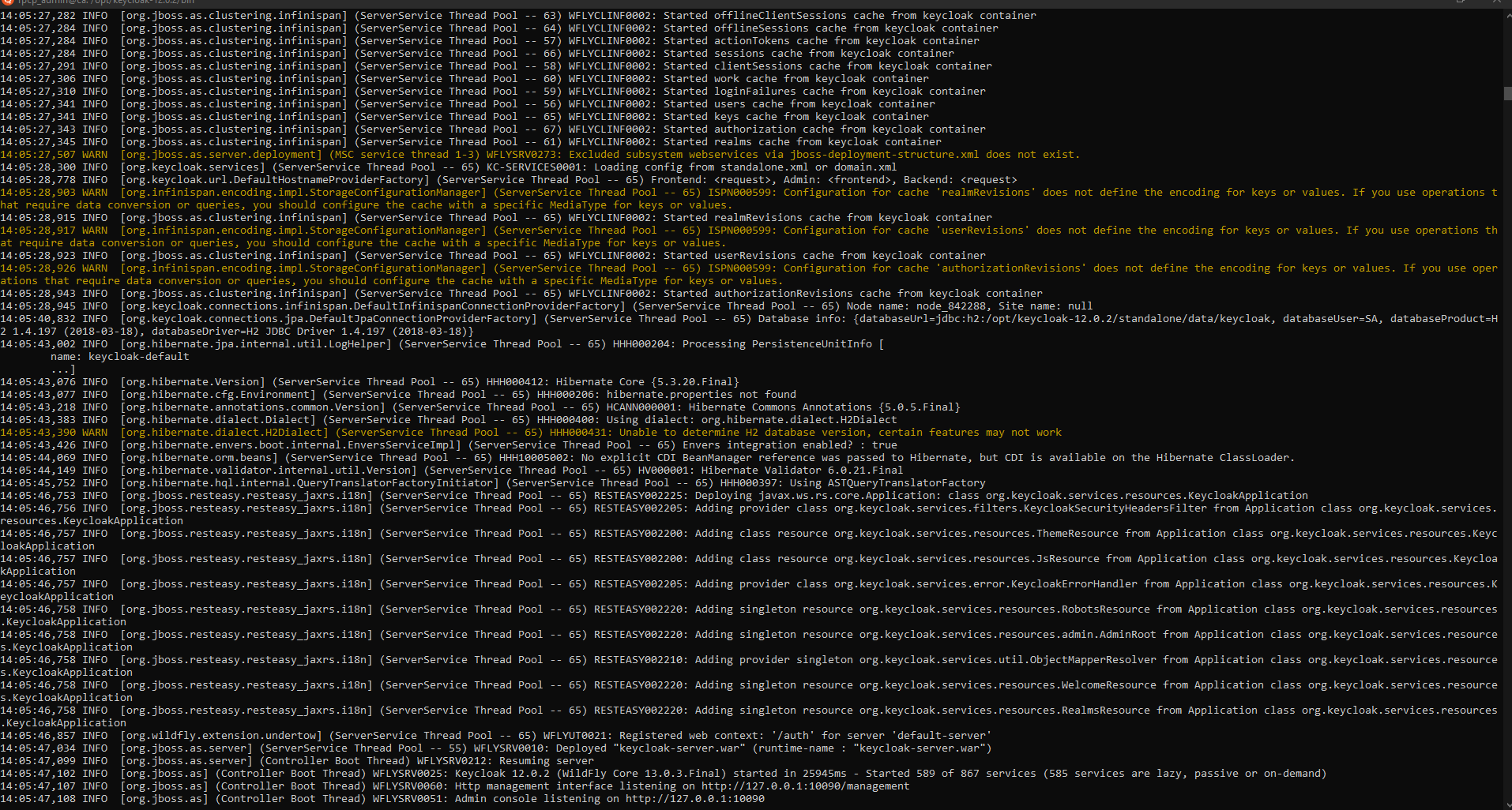

Logs:

Hello thanks for the quick reply .
Now i am suddenly getting .
15:46:59,013 FATAL [org.keycloak.services] (ServerService Thread Pool – 56) Error during startup: java.lang.RuntimeException: Failed to connect to database
Full logs : 15:53:18,406 FATAL [org.keycloak.services] (ServerService Thread Pool -- 62) Err - Pastebin.com
As said this is a fresh ubuntu 16.04 i just downloaded keycloak and runned standalone.sh , it should play right of the box but it’s not , any help would be appreciated.

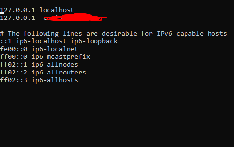

but on hosts i can see 2 lines with
127.0.0.1 localhost
127.0.0.1 prob our hostname.
It’s weird everything worked just fine until i did a clean install of ubuntu again today . Now i regret that.
If i do sudo hostname i get an answer though
should i add that answer
127.0.0.1 hostname_answer ?
this is how etc/hosts
It worked , i will run the command u said now , finger crossed.
